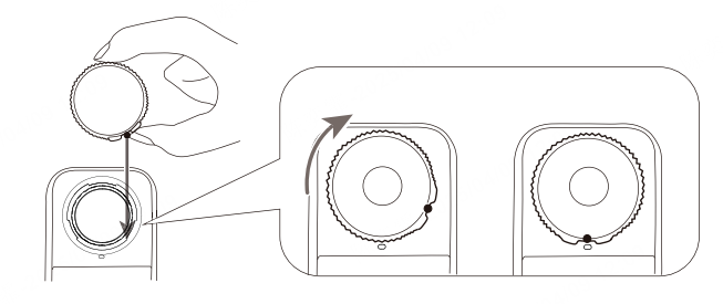

Install the Lens Guards Align the notch on the Lens Guards with the lower right slot of the lens, as shown below. Then, rotate the Lens Guards clockwise until the notch is aligned with the microphone. 示例图片

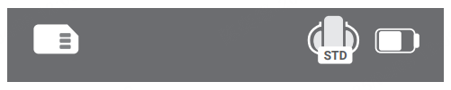

Confirm installation After the Lens Guard is installed on the screen side, the STD icon will appear in the camera's status bar, followed by a pop-up message. Tap the prompt to confirm. 示例图片
Remove the Lens Guards Hold down the edge of the base of the Lens Guards as shown and rotate counterclockwise to remove. After removal, the icon on the status bar will disappear. 示例图片
