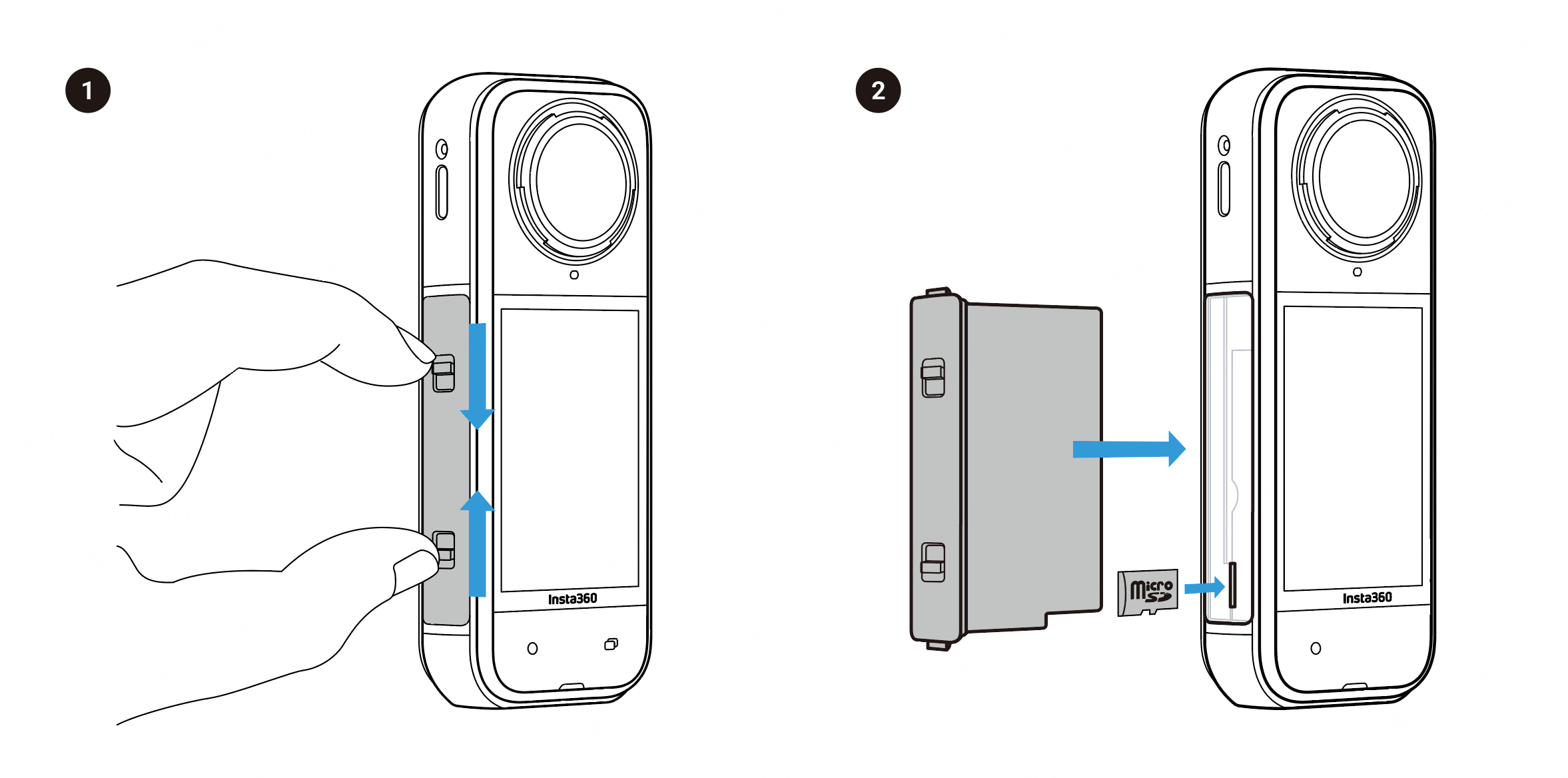

Insert the MicroSD Card
  1. First, remove the battery by pinching the latches on the cover towards each other.
  2. Insert the memory card into the slot in the direction indicated.
  3. Reinsert the battery and make sure the battery cover is locked. The orange indication marks should be covered by the latch to ensure waterproofing is not affected.
Note: Please use exFAT format microSD cards of speed classes UHS-I and V30 or above to ensure normal recording. The maximum supported storage space is 1TB.
