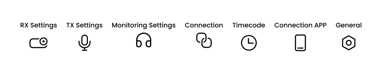

Swipe down on the touch screen of the Receiver to enter the control center.

Adjust screen brightness, language, and date/time. This section also allows for factory resets and provides access to device information and compliance details.
