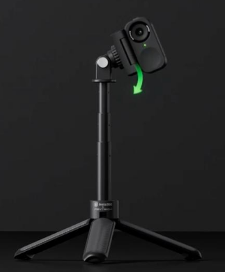

Notes:
  1. When choosing portrait resolution, you can select 4K, 1080P, or 720P in a 9:16 aspect ratio.
  2. The placement of Insta360 Link 2C has orientation restrictions (as shown in the figure below). If the image appears inverted, go to "More" > "Other Settings" in the Insta360 Link Controller and choose "Horizontal Flip" or "Vertical Flip" to correct the inversion, or manually adjust the camera placement direction.
Place the camera sideways with the lens facing upwards
