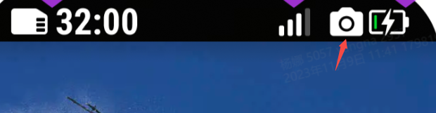

  3. If the remote consumes power quickly when the camera is connected, turn on the "Auto Sleep During Recording" feature in the remote's "Settings" > "Display" and set the Auto Sleep timer.
  4. When the camera is connected, the battery level on the preview interface represents the camera's battery, not the remote's.
  5. Tap the battery icon to change to the remote's battery level.

Q7 How can I check the battery level of my GPS Preview Remote and camera?
When the camera is not connected, you can see the remote's battery level at the upper right corner of the screen.
Tap the battery icon to view the remote's battery level.
