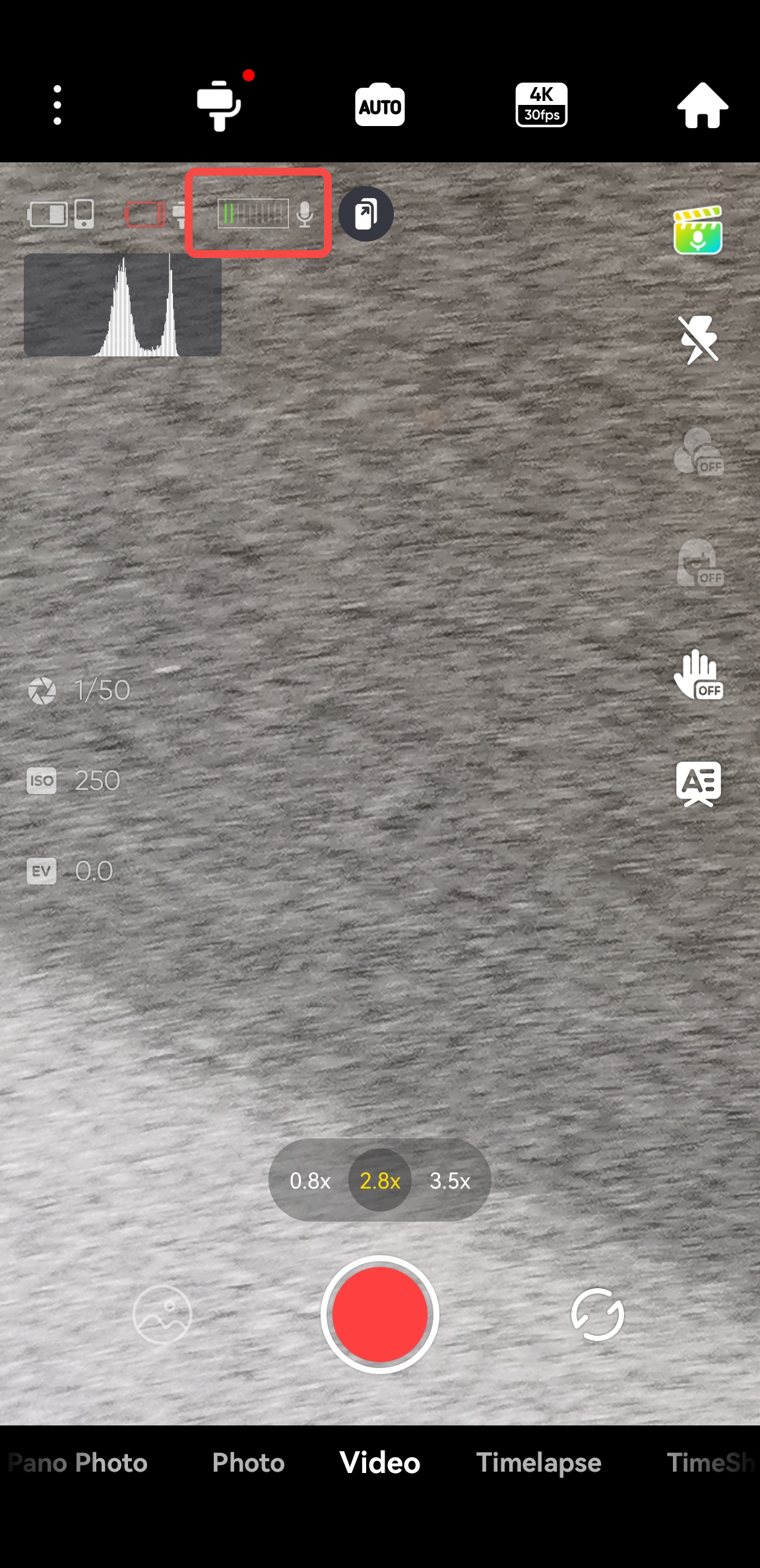

Q3. Can I monitor Mic Air in the Insta360 app when Flow 2 is connected?
Yes. The shooting tab will show a microphone icon in the top left corner, indicating that Mic Air is connected, and a sound wave bar showing the audio levels.
