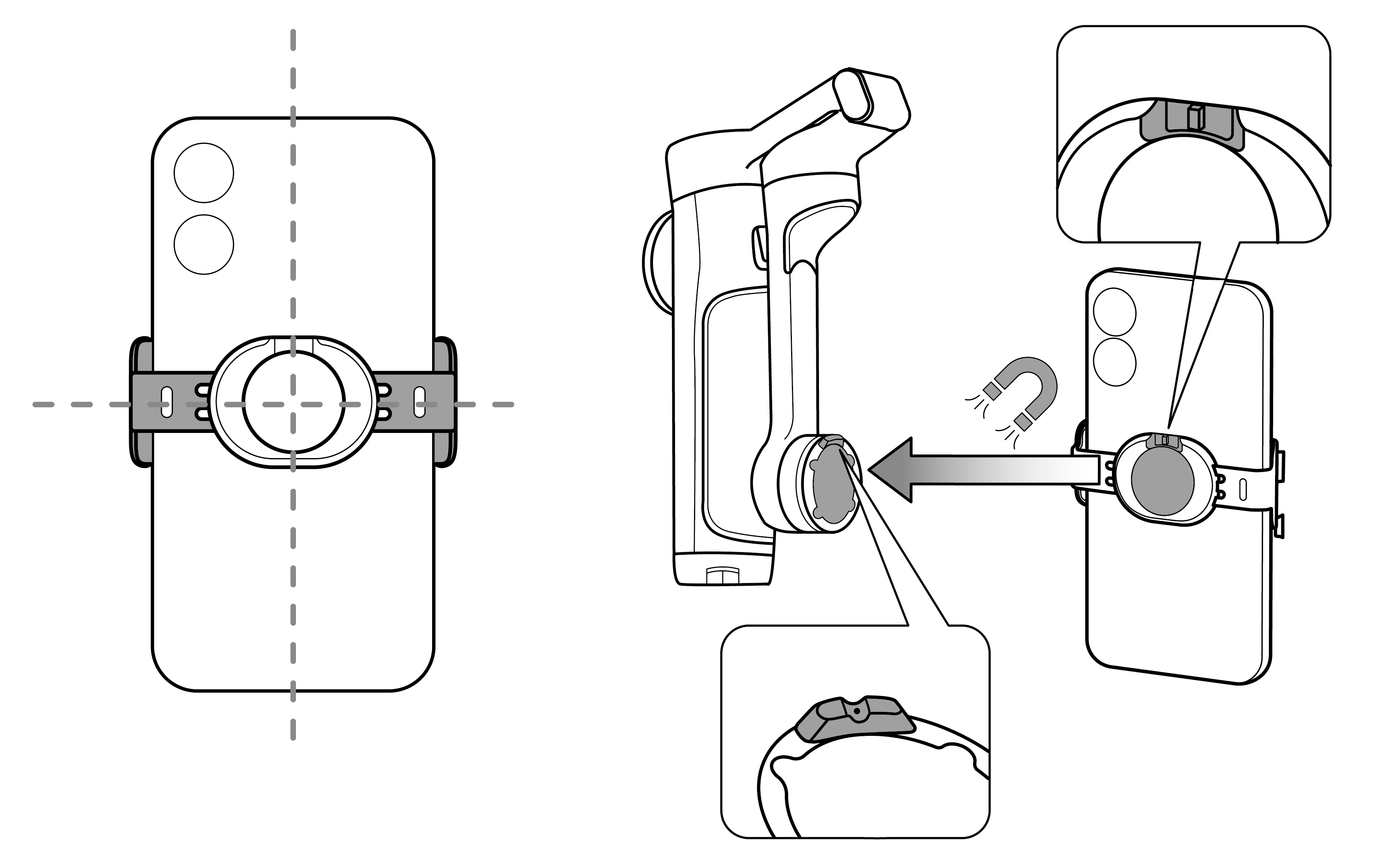

Attach the Phone to the Magnetic Clamp
  • Extend the Magnetic Phone Clamp around the middle of your phone, following the icon on the clamp's right side.
  • Ensure the phone's camera faces the direction marked on the Magnetic Phone Clamp.
Attach the Clamp to the Gimbal
  • Align the magnetic notch on the back of the clamp with the raised bump on the gimbal's magnetic surface.
  • Match the magnetic groove on the clamp with the red dot (Magnetic Alignment) on the gimbal. Securely attach the clamp.

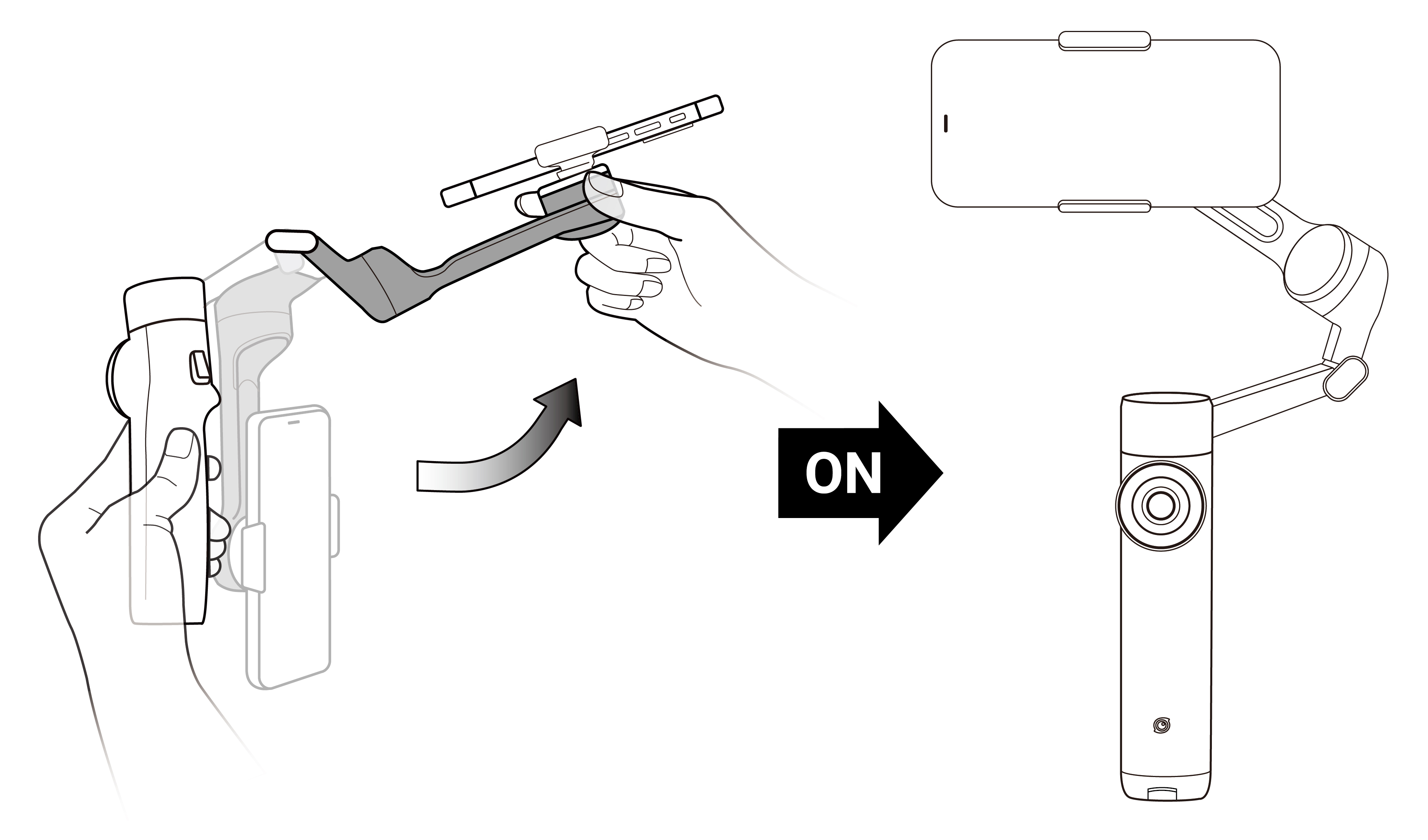

Unfold and Power On
  • Hold the handle with one hand and pull the arm outward with the other to unfold the gimbal.
  • The gimbal powers on automatically. Wait for the indicator light to activate, signaling it's ready for use.

  • Ensure the Magnetic Phone Clamp is centered on your phone for an even, secure fit. Attach the clamp to the phone first before mounting it on the gimbal.
  • The phone's camera should match the direction marked on the clamp for proper alignment.

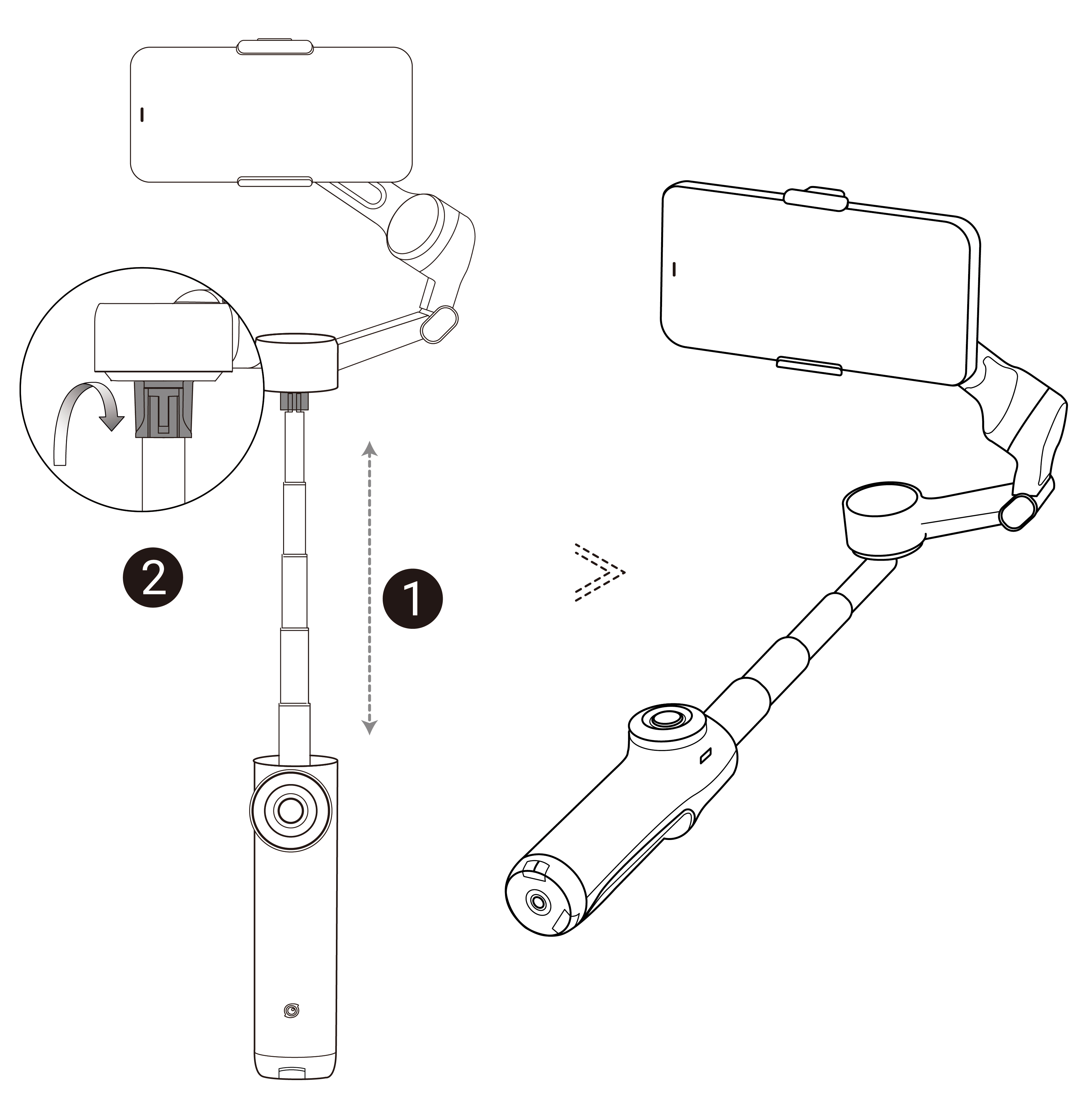

Built-In Selfie Stick and Tripod
Flow 2 comes with a built-in selfie stick and tripod. The selfie stick has five sections and extends to a maximum length of 200mm (7.87in). The angle adjustment range is 0-90°.

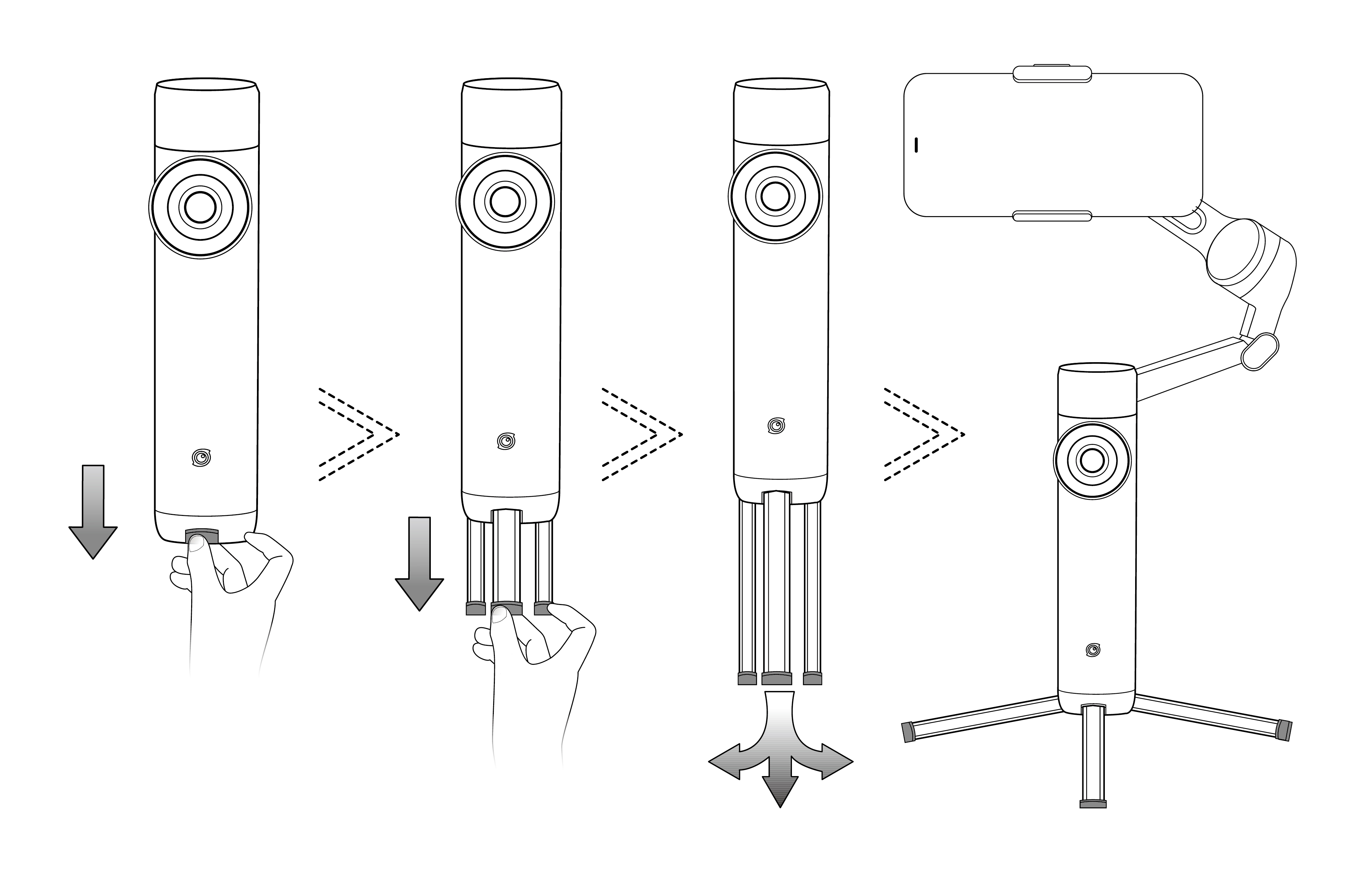

Once fully extended and unfolded, use the built-in tripod for hands-free shooting. Avoid windy, unstable environments, including sand.
Notes:
  • When pulling out the tripod, pull out all legs together, not individually.
  • When storing the tripod, fold the legs first, then slowly push them back in with the palm of your hand.
  • If you have the selfie stick extended for a long time, it's recommended to attach an external tripod through the 1/4" screw hole at the bottom of Flow 2's handle for more support and use in a wider range of scenarios.
Folding and Powering Off
  1. Long press the Power Button to power off Flow 2.
  2. After powering off, hold the phone securely and fold the gimbal arm down to its storage position.
  3. Detach the phone and the Magnetic Phone Clamp.
