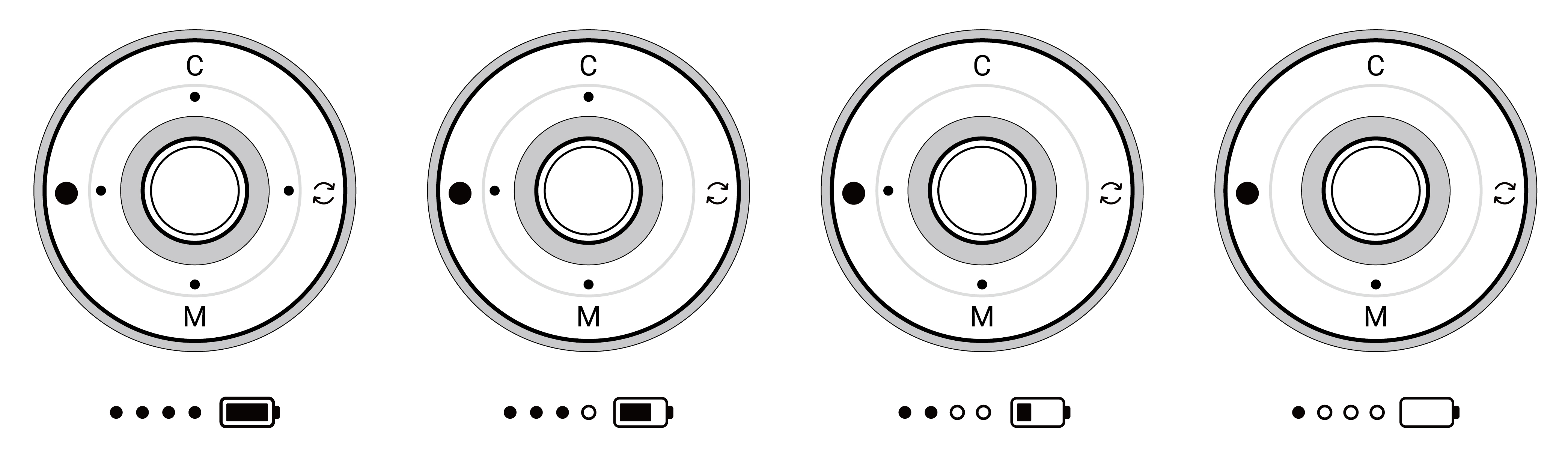

Charging | - The Gimbal Mode Indicator Lights will display the charging status light. If you switch the shooting mode, the lights will display the selected mode for 3 seconds and then return to indicate charging. - The Gimbal Mode Indicator Lights display the charging status light when the gimbal is charging. You can press the Power Button to check the battery level, which will be displayed for 3 seconds, and then the indicator lights will return to indicate charging. ![]() |
